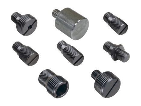

About the Rotary Table Chuck Adapters
You can attach a 1/4″ or 3/8″ drill chuck, an older Unimat chuck with 12 x 1 mm or 14 x 1 mm threads, or a 1/2-20 Sears chuck to your Sherline rotary table. The adapter screws into the 3/8-16 threaded center hole of the table.

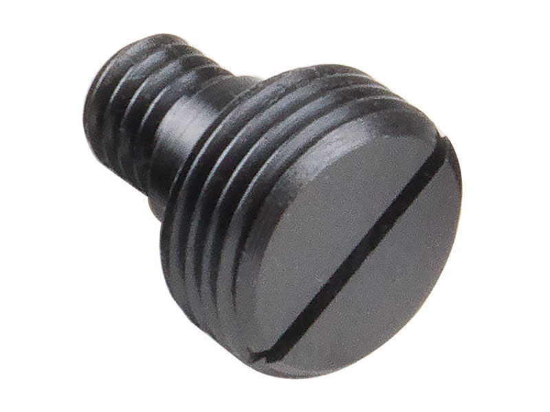

37090 – 3/8-16 to 3/4-16 Chuck Adapter
For use with chucks 1041, 1040, 1040C, 1075, 1076, 1076C, 1076C-PIE, 1044, 1030
37090B – 3/8-16 to 1″ x 1″ Blank Chuck Adapter
This rotary table adapter is the same as our 3/8-16 to 3/4-16 Chuck Adapter (P/N 37090) but without the 3/4-16 thread. Instead of the 3/4-16 thread, it has a 1″ diameter x 1″ long blank that is turned or machined for whatever purpose the user may want, e.g., use it as a locater pin. The adapter is made of 12L14 steel without a finish. It mounts in the center of the Sherline rotary table, as all our chuck adapters do. (See the example picture on the right. The rotary table is shown only for reference and is not included.)
37091 – 3/8-16 to 12 x 1mm Chuck Adapter
For use with chucks 1068, 1077, 1071
37092 – 3/8-16 to 14 x 1mm Chuck Adapter
For use with chucks 1031, 1079, 1035
37093 – 3/8-16 to 1/2-20 Chuck Adapter
For use with chucks 1070, 1073
37094 – 3/8-16 to 3/8-24 Chuck Adapter
For use with chucks 1069, 1072, 3072, 3073
37097 – Rotary Table Chuck Adapter with 15/32″ Through-Hole
The chuck adapter has a 15/32 through-hole with 3/4-16 thread for the chuck and a 5/8-24 thread for the rotary table. The through-hole allows stock to pass through the chuck and P/N 3710 4″ Rotary Table.
For use with chucks 1041, 10401075, 1076, 1044, 1030
37098 – Rotary Table Chuck Adapter (ER-16 thread)
For use with chucks 1042, 1078, 1032
