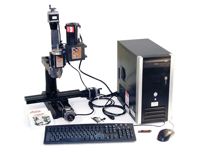

About the Sherline CNC 8-Direction Benchtop Mill
Our CNC benchtop mill is perfect for the customer looking for a mini CNC milling machine to make small, precision parts. The deluxe 8-direction milling machine offers the most versatility of any Sherline mill. In addition to X-axis, Y-axis, and Z-axis travels, there are five additional directions that the headstock spindle can be positioned to do drilling or milling on your part from virtually any angle.
All our CNC milling machines are made in the USA, and our customer service is second to none. Although our machines are small, they can produce high-quality precision parts. Our CNC mill will not only cut wood and plastic but is also rigid and accurate enough to cut aluminum and steel parts. This mill is a desktop-size machine with full-size machine precision and accuracy.
  • 8-Direction Benchtop Milling Machine fitted with saddle oiler, stepper motor mounts, and couplers on X-, Y-, and Z-axes
  • A computer with Ubuntu Linux-based OS with LinuxCNC 4-axis CNC software preinstalled

Standard equipment for the CNC 8-Direction Benchtop Mill includes:
  • 14″ base
  • 2″ column riser block
  • Laser-engraved scales on the base and table
Download PDF 14″ Mill Base Dimensions

Travel, “X” Axis 8.65″ (220 mm) (9″ (228 mm) w/stop screw removed)
Spindle nose taper #1 Morse
Depth Overall* Base footprint: 20.375″ (517.5 mm); With fully extended brass leadscrew cover: 24.375″ (619 mm)
Hold-down provision 2 T-Slots
Shipping Weight 40 lb. (18.2 kg)
Movements in addition
to X-, Y- and Z-axes
Headstock rotation 90° left/right, column rotation (90° L/R), column pivot (front/back), column swing (90° L/R) and 5.5″ column travel (in/out)
CNC Stepper motor holding torque 136 oz-in
Maximum CNC travel positioning speed, X, Y and Z axes 22 inches/min**
