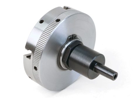

This tailstock live center has a 3/4-16 adapter to hold a 3-jaw or 4-jaw chuck. This live center is used in industrial winding operations, and has a runout of .003″.
