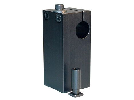

The grinder tool posts are used to hold the high-speed grinder on your lathe for polishing, or fine grinding jobs. The riser grinder tool post when the lathe riser blocks are in place. You can also use the grinder tool post to hold the grinder body on center with your lathe.

Image shows the grinder tool post in place holding the High-Speed Air Grinder (sold separately.)

The high-speed spindle fits into the hole in the toolpost, and a screw is tightened laterally to secure it in place. Do not over-tighten this or the hold-down screw that secures the toolpost to the table. The grinder can be used for putting a fine finish on hard parts, but it does not have the high torque needed to remove larger quantities of metal.

Riser Block Body Material Aluminum
Body Coating Black Anodized
Body Dimensions (H x W X D) 2.75″ x 1.25″ x 1.25″
Hole Dimension .614-.615
