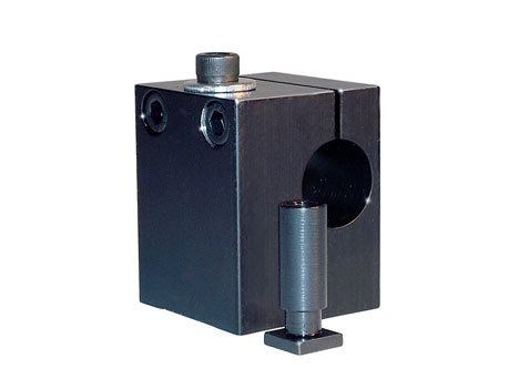

The grinder tool posts are used to hold the high-speed grinder on your lathe for polishing, or fine grinding jobs. The grinder tool post holds the grinder body on center with your lathe. You can also use the riser grinder tool post when the lathe riser blocks are in place.
8976_8900
Image shows the grinder tool post in place holding the High-Speed Engraving Spindle (sold separately.)

The high-speed spindle fits into the hole in the toolpost and a screw is tightened laterally to secure it in place. Do not over tighten this or the hold-down screw that secures the toolpost to the table. The grinder can be used for putting a fine finish on hard parts, but it does not have the high torque needed to remove larger quantities of metal.

Hole Dimension .614-.615
89760 Grinder Tool Post Body 1
40250 Tall T-Nut 1
40340 10-32 x 1″ SHCS 2
40660 #10 Washer 3/16 1
40710 10-32 x 1-1/4″ SHCS 1
