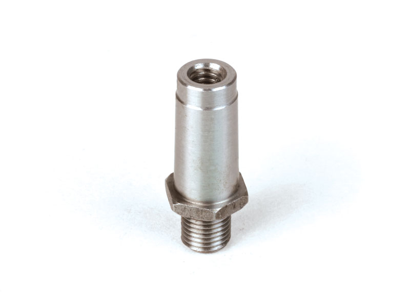

Morse #1 Arbor
Female thread: 1/4-20
Male thread: 3/8-24
SKU: 11880 Category:

    Morse #0 Arbor
    Male thread: 3/8-24
