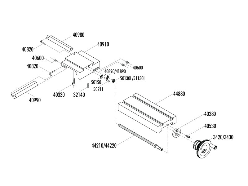

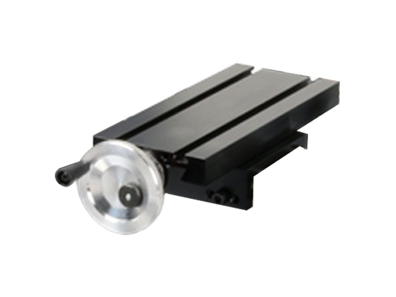

6″ Deluxe Lathe Crosslide and Saddle Assembly – Manual
With 2″ Zero Handwheel
Click on the image for a larver view.
3420
3430
2″ Y-Axis Zero Handwheel (Inch)
2″ Y-Axis Zero Handwheel (Metric)
1
32140 10-32 x 1/2″ Cup Point Set Screw 1
40280 Thrust Collar 1
40330 10-32 x 5/8″ SHCS 1
40530 5-40 x 3/8″ SHCS 1
40600 10-32 x 1/4″ Flat Point Set Screw 3
40820 Gib Lock 2
40890
41890
Slide Screw Insert (Inch)
Slide Screw Insert (Metric)
1
40910 Lathe Saddle 1
40980 Crosslide Gib 1
40990 Saddle Gib 1
44210
44220
6.5″ Slide Screw (Inch)
6.5″ Slide Screw (Metric)
1
44880 6″ Crosslide 1
50130L
51130L
Lathe Anti-Backlash Nut (Inch)
Lathe Anti-Backlash Nut (Metric)
1
50150 Anti-Backlash Lock 1
50211 8-32 x 1/4″ Button Socket Screw 1
