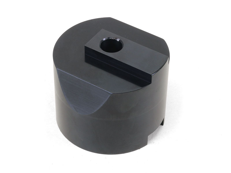

2″ Round Rigid-Column Spacer
Includes extension bolt (not shown)
SKU: 56057 Categories: ,
About the  Round, 2″ Rigid-Column Spacer
This round, 2″ column spacer is designed to be used with the round, rigid-column bases for the 2000-series mills. If you have a 4″ rigid-column base, you can machine right down to the top of the mill table. However, if you have an angle table or a rotary table mounted on your machine, you may want to have the 2″ column spacer to allow for more clearance above the table while using those types of accessories. It is much easier to add the 2″ column spacer than it is to switch out your 4″ column base for the 6″ column base.
NOTE: The overall thickness of the spacer block is within .001″ tolerance, but it is not recommended to use more than one spacer. As more spacers are added, the stack tolerance will increase, and the extra spacers can affect the rigidity and integrity of the machine.
