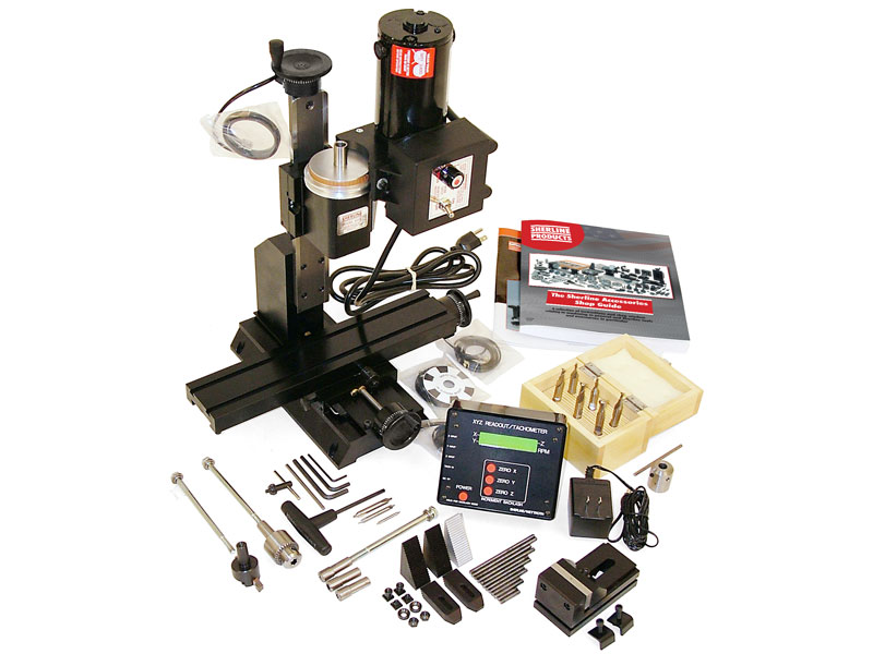

Any Sherline milling machine can be ordered with digital readouts factory installed. The installation includes special handwheels with built-in electronic encoders that replace the standard handwheels. (The standard handwheels are not included when the DRO option is ordered.) These special DRO handwheels are connected to an electronic readout box that translates the handwheel movement into a display of table travel for each of the three axes of movement. The readout for any axis can be reset to zero at any time with the push of a button. Spindle RPM is also constantly displayed on the box whenever the motor is running. The readout can be fitted to either inch or metric machines.
NOTE: The unit does not translate dimensions from inch to metric. It must be initialized to work with the pitch of the leadscrew to which the handwheel is attached
- A DRO display with power supply, and tachometer pickup decal
- 10″ base
- Special handwheels are supplied with DRO machines. These handwheels can be reset to zero electronically with the push of a button on the DRO display box. Sherline DRO mills are outfitted with the special DRO 2″ (51mm) handwheels on the Y-axis leadscrew and X-axis table feed screw, and a 2.5″ handwheel on the Z-axis vertical feed screw. Each handwheel has laser engraved aluminum handwheel collars
- Oil reservoirs on the X/Y axes and the Z-axis to help keep critical parts lubricated. These were initially developed for CNC machines that run constantly for hours on end but can benefit manual machines as well
The A Package Includes:
- Step block hold-down set
- 5/32″ Sherline hex T-driver
- 3-piece center drill set
- Fly cutter w/carbide bit
- 3/8″ end mill holder
- Milling vise

Travel, “X” Axis | 8.65″ (220 mm) | |
Travel, “Y” Axis | 3.00″ (76 mm) | |
Travel, “Z” Axis | 6.25″ (159 mm) | |
Hole through spindle | .405″ (10 mm) | |
Spindle nose thread | 3/4″-16 T.P.I. | |
Spindle nose taper | #1 Morse | |
Spindle runout of Morse taper | .0005″ or less | |
Handwheel graduations | .001″ (.01 mm) | |
Electronically controlled spindle speed range | 70 to 2800 RPM | |
Width Overall* | 14.75″ (375 mm) | |
Depth Overall* | Base footprint: 12″ (305 mm); With fully extended brass leadscrew cover: 12.75″ (324 mm) | |
Height Overall (Max.)* | 20.75″ (527 mm) | |
Table size | 2.75″ x 13.00″ (70 x 330 mm) | |
Hold-down provision | 2 T-Slots | |
Shipping Weight | 43 lb. (19.50 kg) | |
Headstock rotation (90° left/right) | |
Column rotation | (90° left/right) | |
Column pivot | (90° forward/back) | |
Column swing | (90° left/right) | |
Column travel | (in/out) 5.5″ (140 mm) | |
