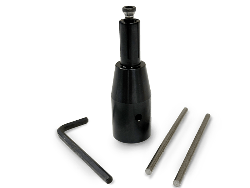

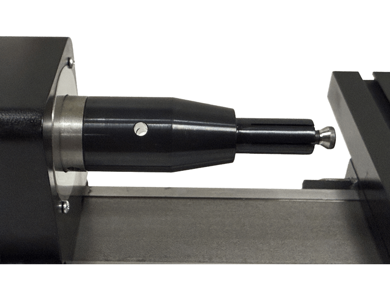

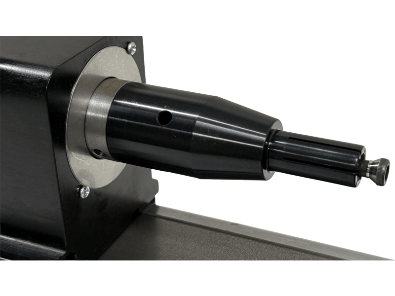

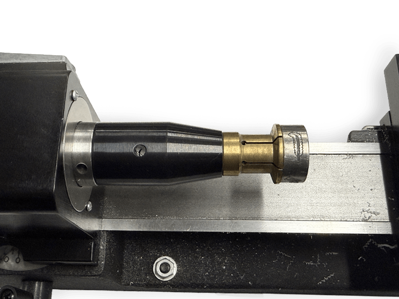

Expanding Ring Mandrel
It is designed for use with stepped ring collets manufactured by Ring Tech (Faceting Collets Stepped). These Ring Tech collets are known for their excellent quality and superior design, and, like our machines, are made in the USA. If you buy collets from Ringtech, tell them Sherline sent you.
P/N 2078 holds jeweler’s burrs with a 3/32" shank.
P/N 2079 is designed for Dremel® tools and other cutters with a 1/8" shank.
- P/N 2080 holds jeweler’s burrs with a 3mm shank.
- Made from 12L14 steel with electroless nickel plating for corrosion resistance
- Tapered body provides greater visual access to the stone during cutting
- ¼" dop hole with 10-32 set screw to secure the dop
- 3/32" locating pin for alignment of angle-cut dops
- Precision-machined with tight tolerances for a secure, accurate fit
- Keyed dop system ensures repeatable orientation and alignment
- Fully compatible with Ultra Tec® brand dops and machines
- High-quality construction - Made in the USA

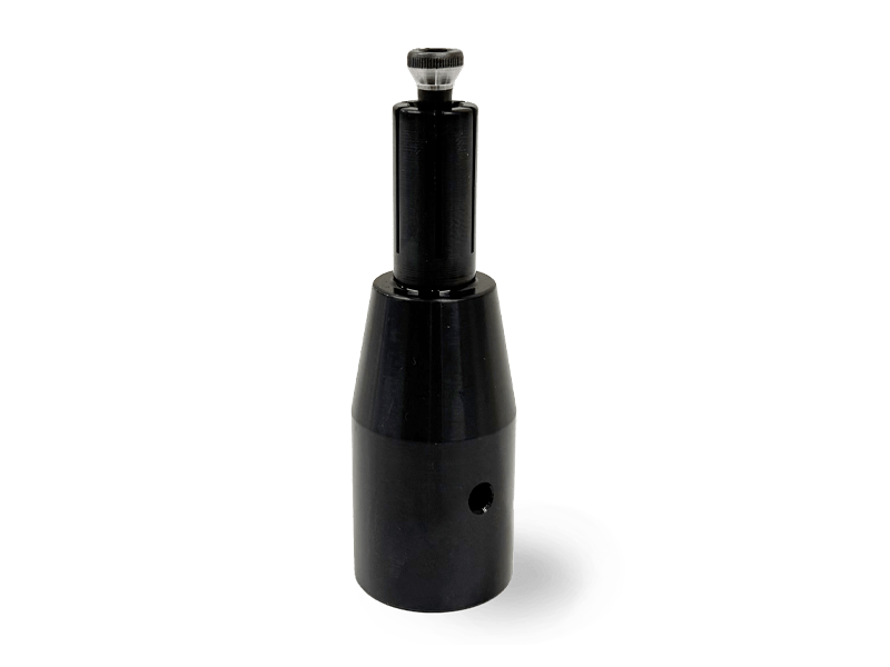

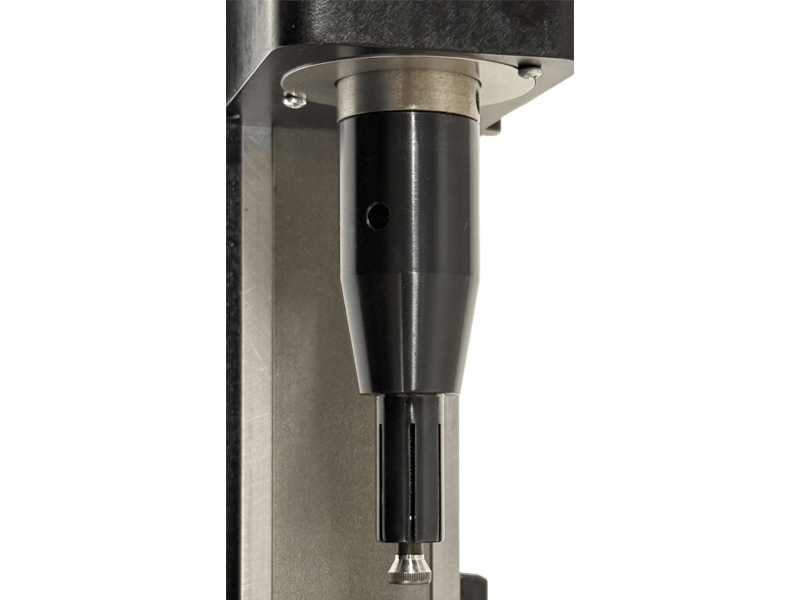

Jeweler Burr Holder
These specialized holders were developed at the request of a jewelry design customer. Similar to our standard end mill holders, they feature a longer body with a tapered end, allowing better visibility of the cutter and improved access for working in cavities.
Each holder includes two Tommy bars and one 1/16" hex key.
