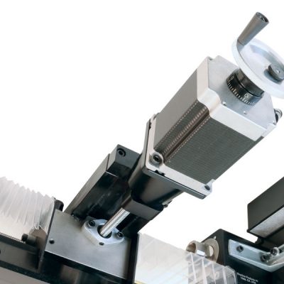

NOTE: CNC-ready machines cannot be operated manually until double-shaft stepper motors are installed.

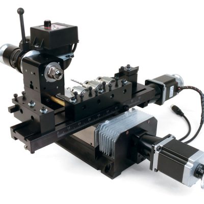

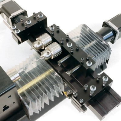

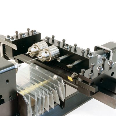

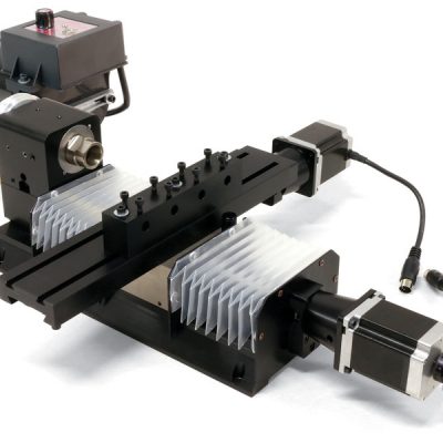

We designed our CNC chucker lathe for our industrial customers who want the convenience of using multiple tools in a single setup. The lathe has a 13″ crosslide that accommodates the 3/8″ gang-tooling tool post and two optional tool posts that can be used for boring and parting tools (tools not included).
NOTE: Machines equipped with ball screws will not include laser-engraved scales on the mill table or the mill base.
Standard Features Include

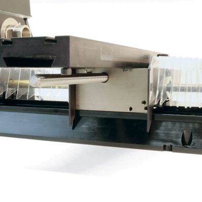

  • Ball Leadscrew*: Rolled Ball Screw with BSH Nut .10mm Diameter, 2mm Lead. C7 Accuracy, P1 Preload. The linear accuracy is 50 micrometers/300mm
  • 3/8″ Gang-tooling tool post that holds up to four tools
  • 14″ Base (Optional upgrade to 18″ available)*
  • 13″ Mill table (Optional upgrade to 18″ available)*
    * NOTE: The axis travel will increase when you upgrade to a longer table or base. The increase will be equal to the length difference for the axis (click the Specifications tab for details).
  • Mill Saddle: Has electroless nickel coating with Teflon. This coating offers a hard surface that is rustproof. The Teflon provides a friction coefficient of .1-.2u for smoother movement of the saddle and the table.

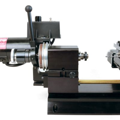

  • 3C Collet headstock: The 3C headstock’s TIR (total indicator runout) is rated at 0.001″ (.0005” or less upon request for an additional $60.00 charge). The 3C spindle is electroless nickel plated to aid in rust prevention and increase its surface hardness for durability.
  • Powerful 90V DC motor with electronic speed controller
  • Accordion way cover and brass-tube leadscrew cover
  • The maximum feed rate is 32 in/min.
  • The largest diameter through the collet is ½” (13mm). NOTE: collets are not available through Sherline Products. We recommend buying them from Hardinge.
*NOTE: See the Specifications tab located above for the Ball Leadscrew and High-Torque Stepper Motor specs.
