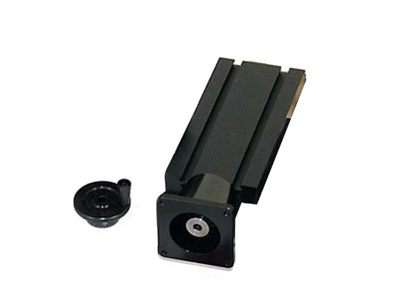

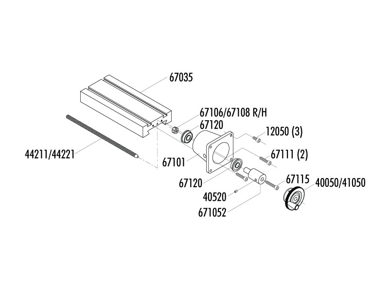

6″ Lathe Crosslide Assembly – CNC Ready
12050 8-32 x 3/8″ SHCS 3
40050
41050
Y Axis Handwheel (Inch)
Y Axis Handwheel (Metric)
1
40520 10-32 x 3/16″ Cup PT Set Screw 1
44211
44221
6.5″ Slide Screw (Inch)
6.5″ Slide Screw (Metric)
1
67035 6″ Crosslide 1
67102 Stepper Motor Mount 1
671052 CNC Coupling 1
67106
67108
RH Coupling Preload Nut – Course (Inch)
RH Coupling Preload Nut – Course (Metric)
1
67111 8-32 x 7/8″ SHCS 2
67115 5-40 x 7/8″ SHCS 1
67120 Stepper Motor Preload Bearing 2
