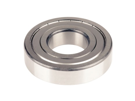

Headstock Class 3 Bearing

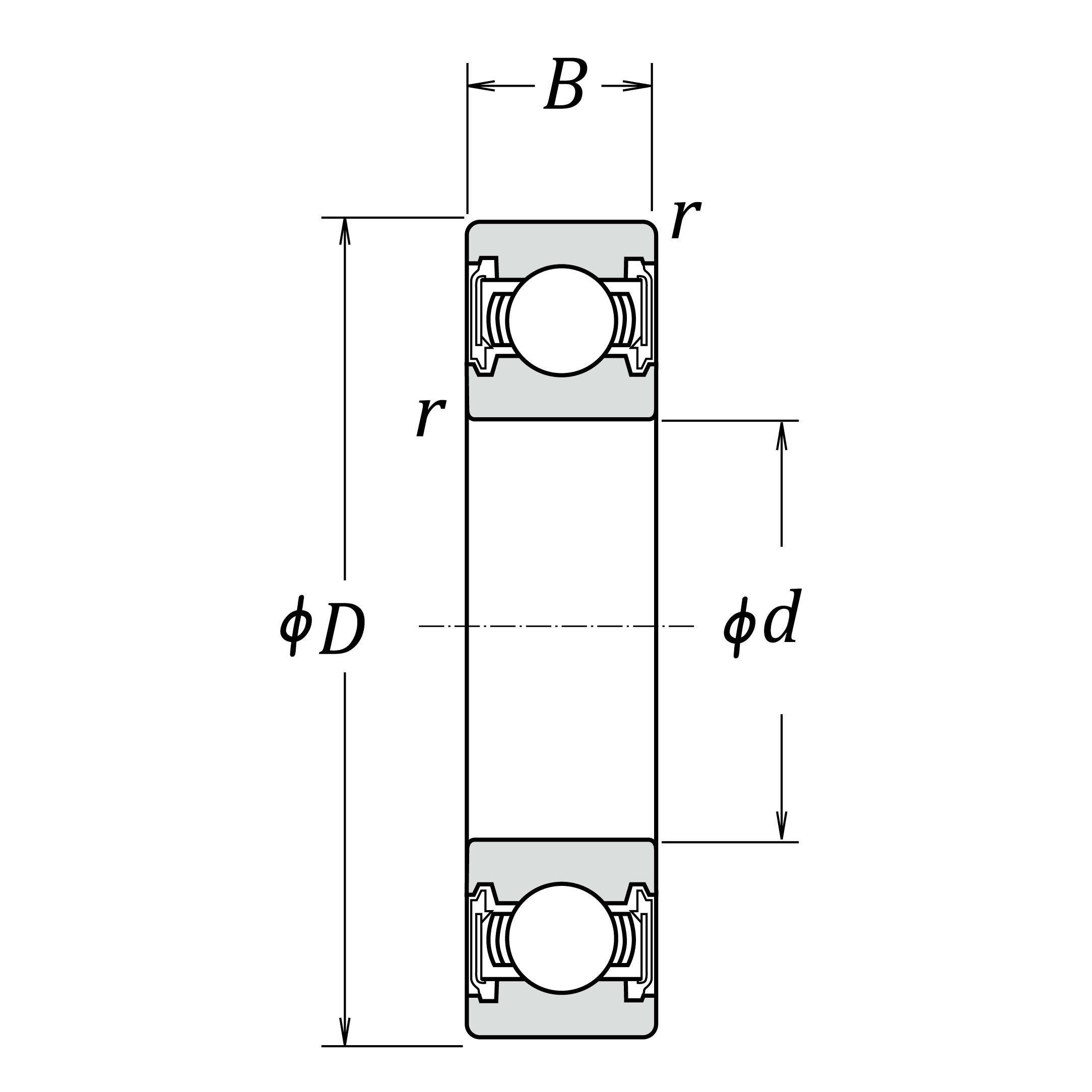

Bore Type Round
Bore Diameter 0.787 Inch | 20 mm
Outside Diameter 1.654 Inch | 42 mm
Overall Height/Width
0.472 Inch | 12 mm

Bearing Type Tapered Roller Bearing
Enclosure Type Metal Shielded
Internal Clearance  C3
Material Steel
