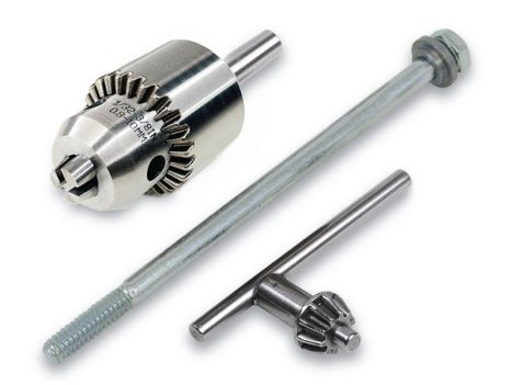

3/8″ Drill Chuck with #1 Morse Arbor
This chuck includes a #1 Morse arbor and drawbolt so that it can be mounted in the headstock of the lathe or mill. It will hold drills from 3/32″ (2.4 mm) to 3/8″ (9.5 mm) in diameter. If runout of less than .003″ amount is required, collets should be used to hold the drill rather than a chuck.
NOTE: Because of its longer length and ability to hold longer 3/8″ drills, this chuck is normally recommended for use on the longer 4400-series benchtop lathes.
| Chuck Capacity | 3/32″ (2.4 mm) – 3/8″ (9.5 mm) | |
| Arbor | #1 Morse for headstock | |
| Runout | .003″ or less | |
| Includes | chuck key, drawbolt+washer and 1 arbor |
| 11861 | Rohm S8 chuck key |
| 11880 | threaded arbor – #1 Morse taper | 11801 | 3/8″ drill chuck body |
| 30880 | 1/4-20 x 5″ drawbolt with centering washer (for #1 Morse arbor) |
