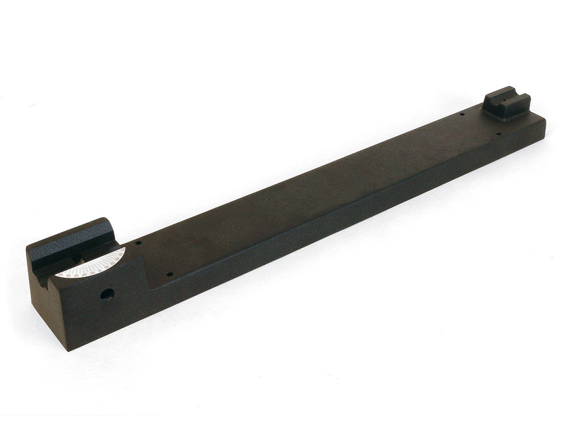

    24″ Machined Lathe Base Assembly
    The machined base replaces our current cast base for our leadscrew lathes. The design is based on our ball screw lathe base. The base is wider for better stability and more rigid than our cast base. It is interchangeable with older 17" benchtop lathes and is a replacement part for the old 24" cast base (P/N 44010)
