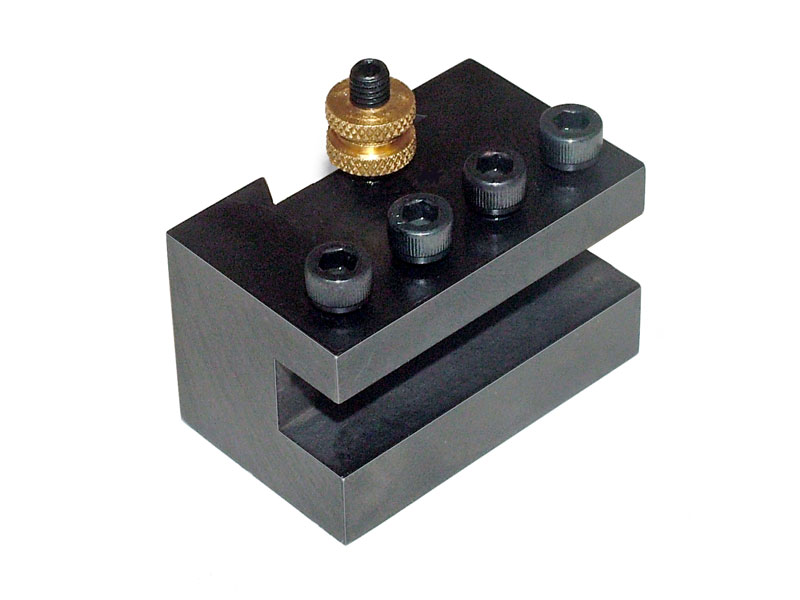

About the Quick-Change 3/8″ Tool Holder
This holder is not included with the P/N 2250 quick-change tool post system but is available as an option for those who wish to take advantage of the superior cutting ability and economy of carbide cutting tools or other tools available in the larger 3/8″ shank size. Sherline offers LH and RH 1/4″ IC tool holders that take 55°, 80°, and groove/threading carbide inserts. This accessory now makes it possible to use those and other tools with the quick-change tool post system.
The P/N 2282 3/8″ holder is not just a 1/4″ holder with a deeper slot to accept 3/8″ tools*. We used a larger billet of material, so you still have plenty of strength to support the larger tool shanks. Which is essential because these 3/8″ tool shanks are usually used to accept carbide inserts, and carbide tools are capable of handling more challenging materials, so plenty of strength in both the toolpost and the holders is needed. This is also why they are made from steel and not aluminum like some aftermarket versions.
*NOTE: This holder will also accept 10 mm tool holders, and there is enough height adjustment to position the cutter on centerline.
For another way to use inserted tip tools with the quick-change tool post, see P/N 2295.
