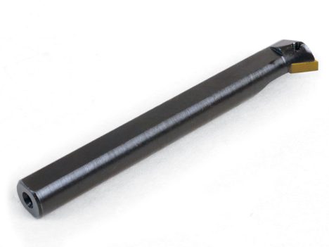

Carbide Insert RH 55° 3/8″ Boring Bar w/2 Flats
Sherline’s gang-tooling tool post (P/N 5930) was specifically designed for customers converting their Sherline lathe into a chucker-style or gang-tooling lathe. Since most parts produced on a chucker lathe are 1/2″ (13 mm) in diameter or smaller, and the center-to-center spacing on our gang-tooling post is 1.5″ (38 mm), we identified a practical opportunity: our boring bars can double as both boring and outside diameter (O.D.) turning tools.
These 3/8″ diameter boring bars are designed to hold a 2-sided 55° carbide insert, secured with a Torx® screw. Each holder includes an 55° carbide insert and a Torx driver.
Each holder is 3-1/4″ long and can bore to a depth of just over 2″ when secured with two set screws.
Constructed from 1144 Stressproof® steel with a black oxide finish for strength and corrosion resistance.
