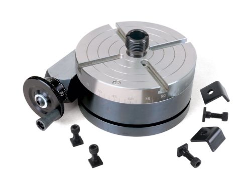

The Nickel-Teflon plating came about after requests from our laser engraving customers. They wanted a rotary table that had a larger through-hole to which you could mount our chucks.
This version of the Sherline rotary table has a Nickel-Teflon plating on the tabletop because it was designed to be used in an everyday production environment. This gives the table a rust-resistant surface that is hard and has added lubrication qualities.
NOTE: The rotary table “TOP” is the only part of the rotary table assembly that has nickel-Teflon plating.
The table is 2″ high and 4″ (100mm) in diameter. The main components have been machined from solid bar stock steel, and the complete unit weighs seven pounds. The table has been engraved with a laser, giving sharp and precise lines every 5°, numbered every 15°. These lines are calibrated with the 72-tooth worm gear that is driven by the handwheel or stepper motor. The handwheel is divided into 50 parts, making each line on the handwheel 1/10°. This allows a circle to be divided into 3600 increments without interpolation. Seventy-two revolutions of the handwheel rotate the table one revolution.

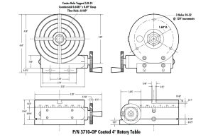

Features include:
  • The through-hole on this rotary table is 15/32″ (.469″)
  • The chuck adapter has a 3/4-16 thread for the chuck and a 5/8-24 thread for the rotary table
  • There is a .6485″ c’bore at the entrance of the 5/8-24 thread, which is used to locate the adapter concentric to the rotary table (See Figure 1 below)
NOTE: To use this rotary table with our Tilting Angle Table (P/N 3750), you will need to drill out the 10-32 center hole to 1/2″ diameter. This will allow the maximum diameter of stock to feed through the rotary table (See Figure 2 below).
