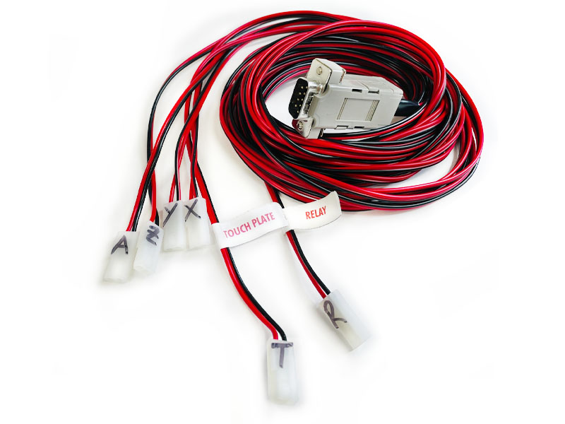

Main Limit-Switch Cable
SKU: 87825 Category:
    9400_pic1
    9400_pic1
