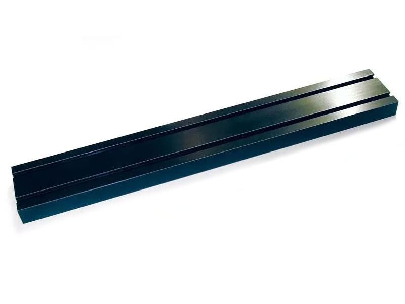

18″ Extended Mill Table
By popular demand, particularly in the CNC market, Sherline now offers an extended mill table that is 18″ long, extending the X-axis travel to 12.38″. It is the same width and thickness as the standard 13″ table and the T-slots are the same distance apart, so all Sherline accessories will work with it. This table does not have the laser engraved reference scale used on the original equipment 5400 and 2000-series mill tables. This allows us to use it in both metric and inch applications for savings on this limited production item.
You can order it as an option on a new mill, or as an updated replacement for your current Sherline mill. You will also need to purchase the appropriate leadscrew.
Download PDF 54182 Instructions
Material Aluminum
Body Coating Black Anodized
Table size 18″ x 2.75″ x .875″ (458 mm x 70 mm x 22 mm)
X-axis travel 12.38″ (314 mm)
Hold-down provision 2 T-slots
Overall weight 3.5 lb (1.6 kg)
