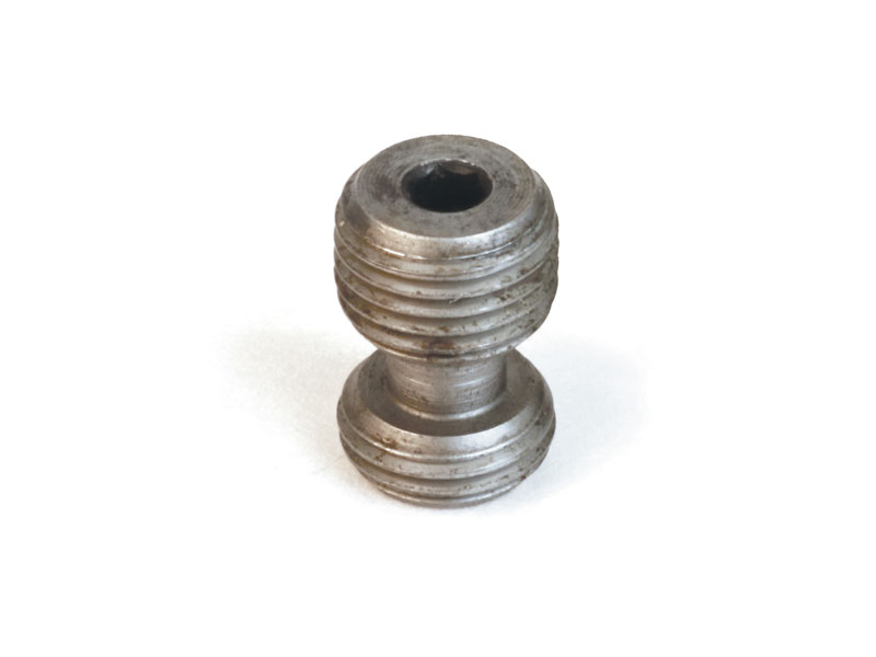

2.5″ 4-Jaw Independent Chucks – Various Thread
Includes hex key, not pictured
These chucks have four advantages over 3-jaw chucks.
This is a valuable asset when machining cams, crankshafts, and similar parts. The main disadvantage of the 4-jaw independent chuck is that the jaws must be set individually, adding considerable setup time. The jaws are reversible to accommodate larger stock.
NOTE: The independent chucks don't have Tommy bar holes like the scroll chucks because most people use the 5/32" hex wrench into one of the jaw screws to thread the chuck on and off. Our P/N 3020 5/32" Hex T-Driver works perfectly.
Like the Sherline 3-jaw chucks, the 4-jaw chucks can clamp either externally or internally. Although we recommend the 3-jaw chuck for standard lathe projects, the 4-jaw chuck is considered the accessory that could add the most versatility to your machine. If you feel the 4-jaw chuck would be more useful, and you have no need for the 3-jaw chuck, any lathe “A” package can be ordered with the 4-jaw chuck substituted for the 3-jaw upon request. A clamping groove allows the chuck to hold parts for milling.
