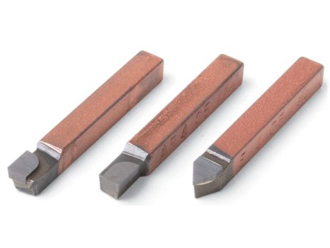

1/4″ Brazed Tip Carbide Tool Set
Carbide tools have a small piece of tough carbide brazed to the tip of a softer steel shank. These tools are recommended for cutting hard or abrasive materials. Carbide tools can retain their hardness at temperatures up to approximately 1700°. This permits a higher cutting speed and faster feed rates.
They are typically harder to sharpen than their HSS counterparts. A silicon carbide or diamond grinding wheel must be used. The shape of carbide tools is also more critical than the shape of high-speed steel cutters, but their cutting ability on tough or abrasive materials makes them very popular. If you are cutting a material that quickly dulls your HSS cutters, you will find carbide tools might be just what you need.

NOTE:  A tool is named by the direction from which the chip leaves the tool; so a right-hand tool has its cutting edge on the left and the chip peels off to the right.
Right Hand
Size 1/4″
Tool Nr AR4
Grade C5
Cutting Direction Right Hand
Overall Length 2″
Style AR
Tool Material Carbide Tipped
Type Carbide Tipped Tool Bit
Left Hand
Size 1/4″
Tool Nr AL4
Grade C5
Cutting Direction Left Hand
Overall Length 2″
Style AL
60° Threading Tool
Size 1/4″
Tool Nr E4
Grade C5
Cutting Direction Threading Tool 60° Included Angle
Overall Length 2″
Included Angle 60° Included Angle
Style E
