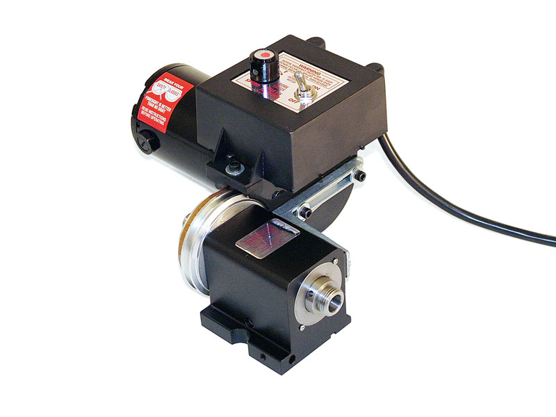

Our standard headstock has a Morse #1 Taper spindle with 3/4 x 16 threads to accept 3/4 x 16 tools. The headstock includes a spindle pulley and a precision ground head key.

There is a subtle change in the color of the coated spindle, but in the absence of comparing them side by side, the most evident way to tell whether you have a coated spindle is to check for the witness mark. There is a machined groove on the shoulder of the spindle where you would insert a Tommy bar. We add this groove at the factory so we know which spindles to send out for the plating process. (See Figure 1. Click on the photo to view a larger image).

The powerful DC motor offers maximum torque at low RPM, where you need it most in machining. This means it provides far more useable power than an AC/DC motor of equivalent or larger size. It also offers smoother and quieter operations than an AC/DC motor.
A sophisticated speed control unit powers and controls the motor. The speed control unit accepts any incoming AC from 100 VAC to 240 VAC, 50 or 60 Hz, and automatically outputs 90V DC to the motor so that this unit can be used anywhere in the world without a transformer. All you need is the correct wall plug or converter. Once the on/off switch is switched to the “ON” position, a speed control knob is used to vary the entire range’s speed. With the pulley in the “normal” position, the speed range is about 70 to 2,800 RPM. In the “high-torque” position, the maximum speed is cut in half, but torque at any given speed is much greater*.
*NOTE: Full torque at the lower RPM range of 70-1,400 will be obtained when the motor pulley belt is in the low-speed/high-torque pulley groove. The high-speed pulley groove will have full torque in the 1,200 to 2,800 RPM range.
