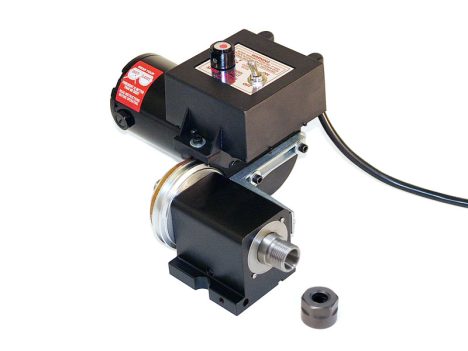

About Sherline’s ER-16 Headstock
It is for use on a Sherline lathe or mill in place of the standard headstock if you want an ER-16 spindle.
The ER-16 nut that ships with your order may be plain or have a black oxide finish. The headstock includes a spindle pulley and a precision ground head key.
NOTE: If the ER-16 nose is ordered, no Sherline accessories that use a #1 Morse taper or 3/4-16 thread will work on this spindle.

Custom Build Your ER-16 Headstock with the Following Options:
  • Class 3 or Class 5 Bearings
Bearing Options
The C3 bearings have been standard in all of our headstocks for years and have proven reliable over that time.
The C5 bearing headstocks come at a higher price than the standard C3 bearings headstocks, but they run smoother, quieter, and cooler than our regular class 3 bearing headstocks and are more suitable in an industrial setting.
The powerful DC motor offers its maximum torque at low RPM, which is what you need most in machining. This means it provides far more useable power than an AC/DC motor of equivalent or larger size. It also offers smoother and quieter operations than an AC/DC motor.
A sophisticated speed control unit powers and controls the motor. The speed control unit accepts any incoming AC current from 100 VAC to 240 VAC, 50 or 60 Hz, and automatically outputs 90V DC to the motor so that this unit can be used anywhere in the world without a transformer. All you need is the correct wall plug or converter. Once the on/off switch is switched to the “ON” position, a speed control knob is used to vary the entire range’s speed. With the pulley in the “normal” position, the speed range is about 70 to 2,800 RPM. In the “high torque” position, the maximum speed is cut in half, but torque at any given speed is much greater*.
