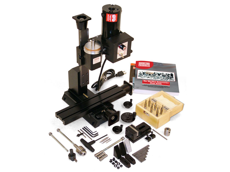

Any Sherline mill can be ordered with stepper motor mounts factory installed in place of the handwheels and ready for the application of stepper motors and computer numeric controls (CNC). Sherline supplies the mounts, and several aftermarket suppliers offer motors, drivers, and software to complete the CNC system. You supply the 486 or better computer. See our CNC Dealers page for a list of supplies and links to their home pages.
Sherline recommends using dual shaft stepper motors so that handwheels can be applied to the rear shaft for manual control. With that in mind, handwheels for each axis are included with the machine, although they cannot be used until stepper motors are installed. Sherline also offers high-quality stepper motors, which can be found in the accessories section of this site.
- 10″ base
- The handwheels are included and can be mounted to the end of the stepper motors to maintain manual control when needed.* Standard 1-5/8″ (41mm) handwheels for the X- and Y-axes, and one 2-1/2″ (63mm) with thrust bearings for the Z-axis. Each handwheel has laser engraved aluminum handwheel collars
*NOTE: CNC-ready machines cannot be operated manually until stepper motors are installed. - 2.75″ (70 mm) x 13.0″ (330 mm) table with two T-slots
- Oil reservoirs on the X/Y axes and the Z-axis to help keep critical parts lubricated. These were initially developed for CNC machines that run constantly for hours on end but can benefit manual machines as well
The A Package Includes:
- Step block hold-down set
- 5/32″ Sherline hex T-driver
- 3-piece center drill set
- Fly cutter w/carbide bit
- 3/8″ end mill holder
- Milling vise
