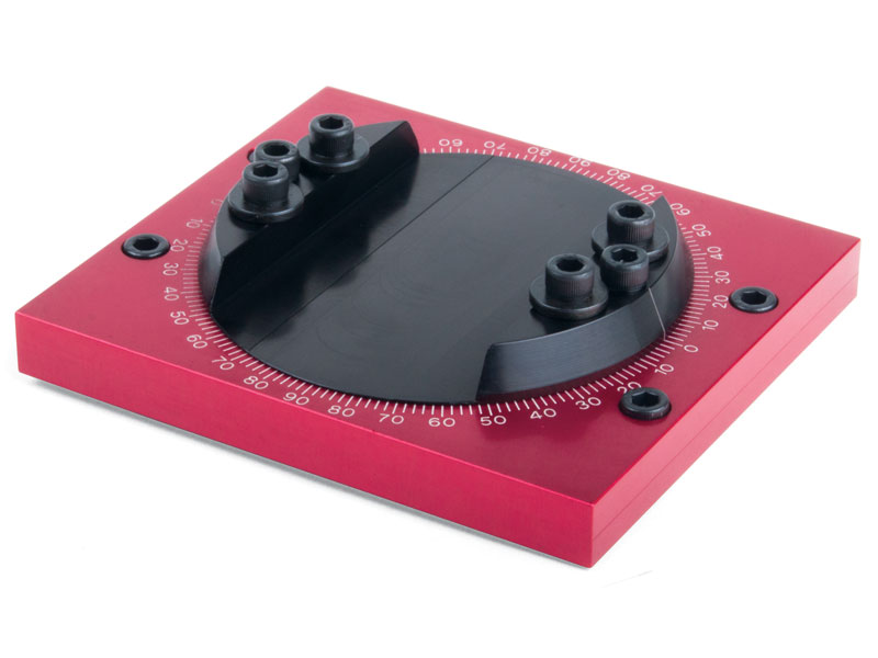

About the Rotating Mill Vise Base
When mounting the mill vise to the table, this base will allow the vise to be rotated to any angle. The red anodized base is laser engraved with angle measurements in 1° increments all the way around. A witness mark is engraved on the side of the rotating collar that holds the vise. The locking washers can be loosened, which allows the vise to slide forward and back in the fixture for further adjustment. A locking ring underneath pulls the collar down onto the base to lock it securely when the two hold-down screws are tightened. The low-profile tooling plate base only raises the height of the vise 1/2″. Four T-nuts and hold-down bolts are included.
The rotating vise base eliminates clamping and unclamping the vise to produce angles. Once mounted square to the table, the vise can be positioned using the laser engraved protractor scale as a guide for setting the angle. Properly positioned, the rotating base can even be used as a simple rotary table to drill or machine small, radially symmetrical patterns.
