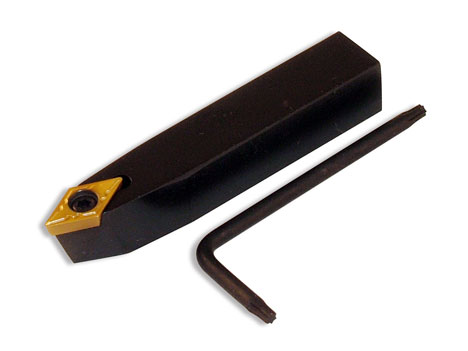

Straight Insert Tool Holder w/55° insert

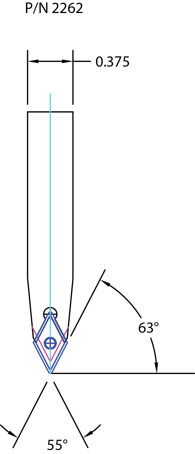

This holder features a centered design (not offset to either side) and includes a 55° carbide insert, a hold-down screw, and a Torx key for installation. It has a 3/8″ square shank that fits standard 3/8″ tool posts. The straight tip design allows for general-purpose turning operations in either direction. The cutting tip is positioned 0.375″ from the bottom of the holder, which conforms to industry standards. The holder is constructed from case-hardened steel and finished with black oxide for enhanced durability and corrosion resistance.
Though more costly than traditional tools, each insert offers two usable cutting edges. When one edge becomes dull or chipped, simply rotate the insert 180° to access a new cutting surface—essentially providing two tools in one.

These tool holders are available individually in right-hand or left-hand configurations, or as a matched pair. Each holder includes a 55° carbide insert, a hold-down screw, and a Torx® key for installation. Designed with a 3/8" square shank, they fit standard 3/8" tool posts, and the insert tip is precisely 0.375" from the base of the holder—an industry-standard dimension.
The 5° offset angle of the cutting tip provides added versatility for certain operations. For example, when the holder is squared with the crosslide, it allows you to turn an outside diameter (O.D.) up to a shoulder and then finish the shoulder by backing the tool out—while maintaining proper tool clearance.
