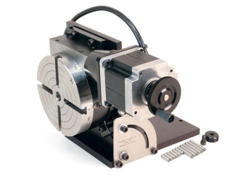

Laser Engraving Tilting Angle Table (Chuck and Rotary table not included. Shown for reference only.)

We came up with the concept of this tilting angle table for laser engraving because we realize that most laser engraving shops don’t have access to a machine shop that can make special fixtures for their parts. Most laser engraving shops have an assortment of blocks, and pins, and shims that they will use to build a “less than accurate” setup to hold parts on an angle.
This accessory offers a great variety of setup options. It was designed to accept several of our other laser engraving accessories, such as our CNC rotary table (P/N 8730) and our 3-jaw chuck with pin jaws (P/N 1140). The table also has (66) “dual purpose” 3/16″ holes. These holes are reamed on the top half to accept 3/16″ steel dowel pins (for locating parts) and tapped 10-32 on the bottom half so you can use hold-down clamps.

The table can be set at any angle from 0° to 90° in order to hold your part with the tapered surface perpendicular to the laser beam. The tilting angle table can be clamped to any flat surface or held in a vice. The base also has a hole pattern so it can be mounted easily to our Laser Engraving Plate & XY Slide w/18″ Table (P/N 6540LAZ).
Angle table mounted on engraving plate
Engraving laser in progress
