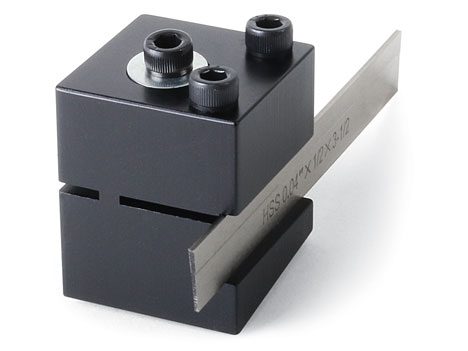

After completing a part in the lathe it is frequently necessary to separate the part from the excess material used for chucking. This operation is best accomplished with the use of a cutoff tool or “parting tool” as it is sometimes called. The Sherline cutoff tool and holder consist of a very slender high-speed tool steel cutting blade mounted in a special holder. The thinness of the blade (.040″ or 1 mm) enables it to feed into the part quite easily, and, at the same time, minimizes the amount of waste material. The turning speed for parting should be approximately one-half the normal turning speed for any given material.
The cutoff tool can be used on the “back” side of the tool post with the addition of the rear mount riser (shown below).
