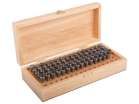

Complete Metric WW Collet Set
The Sherline metric WW collet set contains 77 collets sized from 0.3 mm to 8.0 mm by 0.1 mm increments plus a blank collet that can be made into any size collet by the user. It comes in a finely finished hardwood box with 96 holes, leaving room for other collets should you have extras or inch sizes to store.
