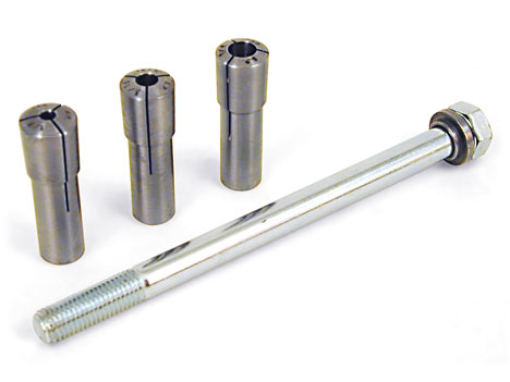

Sherline milling collets are specifically designed for use with the Morse #1 internal taper, which is standard on both the Sherline lathe and vertical mill. Due to the shallow angle of the Morse #1 taper, tightening the drawbolt results in significantly greater clamping force compared to WW collets. For this reason, we recommend using these milling collets to securely hold miniature end mills (with 3/16″ or 1/4″ shanks), #1 and smaller center drills, Dremel® bits (1/8″ shank), and a variety of other small cutters.
Inch Mill Collet Set: 1/8″, 3/16″, 1/4″
Metric Mill Collet Set: 3 mm, 4 mm, 6 mm
Note: Tools held in these collets must have a shank diameter within .001″ of the stated size. Because of the shallow taper, the collet will remain tight in the spindle even after loosening the drawbolt. To release it, back the drawbolt out a few turns and tap it lightly to free the collet.

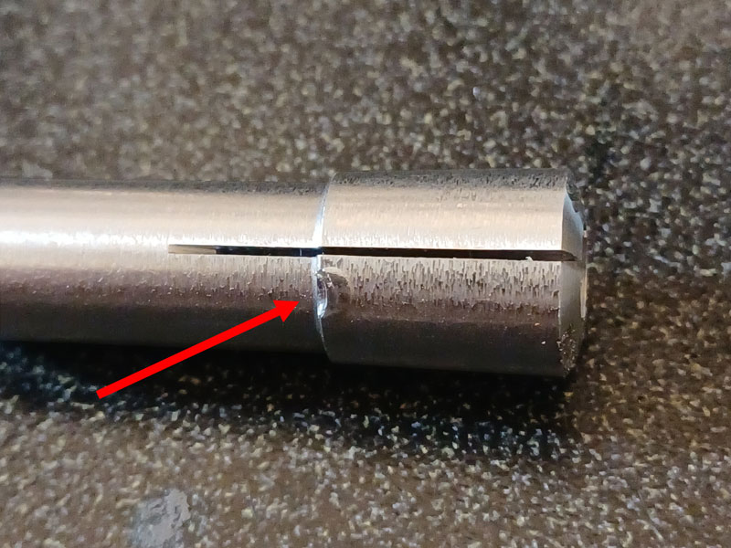

⚠️ CAUTION: When tightening the collet drawbolt with a Tommy bar, be careful not to insert the bar too far into the spindle. Doing so can damage the collet’s taper area. The red arrow in the image below shows an example of this type of damage.
