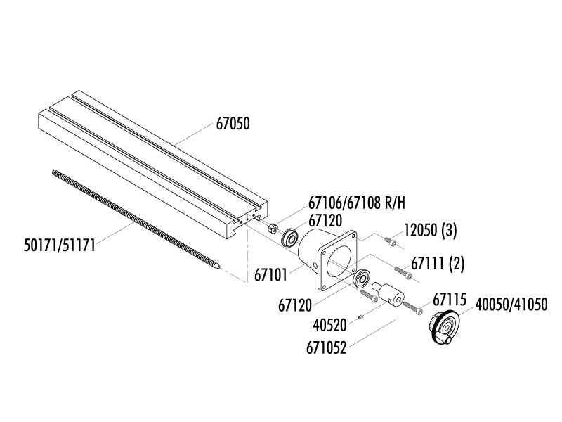

The CNC-ready crosslide includes a CNC leadscrew, a standard 1-5/8″ handwheel, and a stepper motor mount.
About CNC-Ready Crosslides
Sherline CNC-ready lathe crosslides have factory-installed stepper motor mounts in place of the handwheels and are ready to apply 23-frame size stepper motors and computer numeric controls (CNC). CNC-Ready crosslides cannot be used until stepper motors have been installed.
