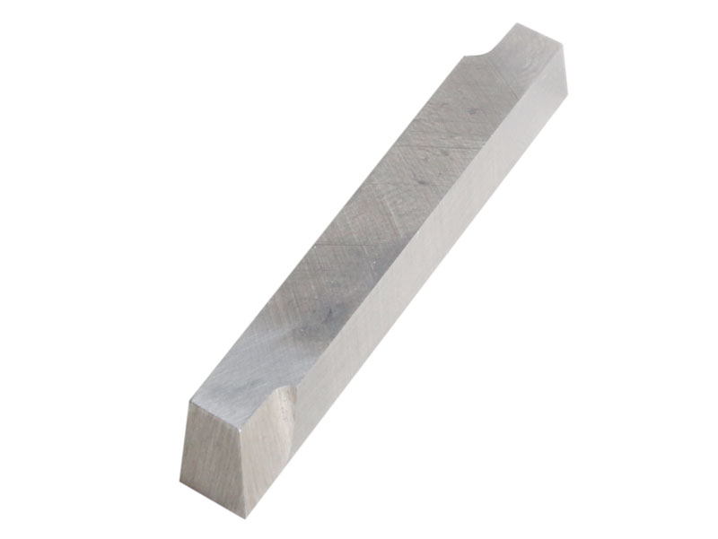

The vertical sheer tool bit is similar to a finishing tool that is used on shapers. This tool is used for finish turning only. You use this tool after you have rough turned your parts to .003″ to .010″ oversize. The recommended depth of cut for this style of cutting tool is .001″ to .003″. If you leave more than .003″ for your finish cut, you will need to take several finish passes with this tool.

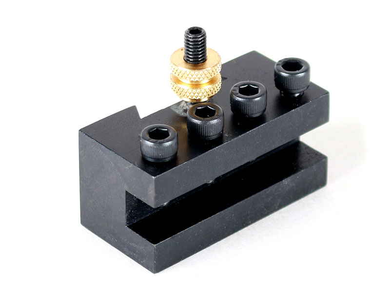

Because the Vertical Sheer Bit is specifically designed to NOT cut on center-line, it is not compatible with standard Sherline tools holders. To function properly, the Vertical Sheer Bit should be used in conjunction with the Quick-Change 1/4″ Tool Holder on the Sherline Quick-Change Tool Post.

The vertical sheer bit held in the 1/4″ tool holder on the quick-change tool post.
