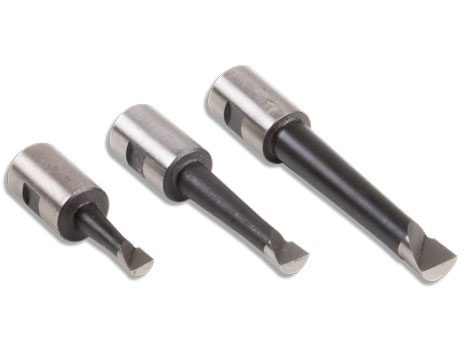

These high-speed steel cutting tools are designed specifically for use with the Sherline boring head and feature a 3/8″ (9.5 mm) diameter shank.
  • P/N 3061 is suited for holes with a minimum diameter of 1/4″ (6.4 mm) and a maximum cutting depth of 0.600″ (15.2 mm).
  • P/N 3063 works with a minimum hole diameter of 5/16″ (7.9 mm) and provides up to 1.00″ (25 mm) of cutting depth.
  • P/N 3064 also fits a 5/16″ (7.9 mm) minimum hole but offers an extended 1.5″ (38.1 mm) reach.
If needed, the tools can be ground to fit smaller hole diameters. They may also be used in the 3/8″ round-hole tool post on a lathe for boring operations. Each tool includes a ground flat on the shank to provide a secure surface for the boring head setscrew.
