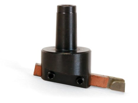

Fly Cutter, includes left-hand cutting tool and drawbolt (not shown).
SKU: 3052 Category:

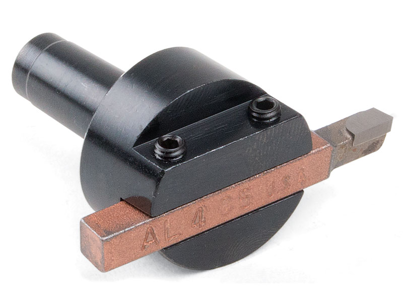

About the Fly Cutter
Fly cutters are used primarily on a milling machine for machining large, flat surface areas. The fly cutter is a single-point cutting tool similar to a lathe tool mounted in a special holder. The cutter can be adjusted to cut up to a 2.00″ (51 mm) diameter and is easily capable of taking a .010″ (.25 mm) deep cut in aluminum at this diameter.
The Sherline fly cutter comes complete with the holder, a drawbolt, thrust washer, and a left-hand brazed 1/4″ carbide cutting tool. It is a worthwhile addition to any shop.
