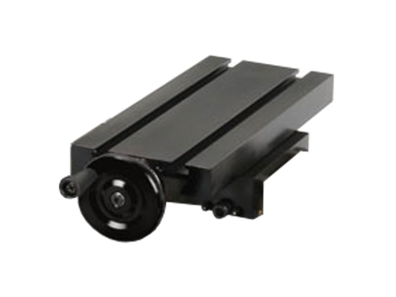

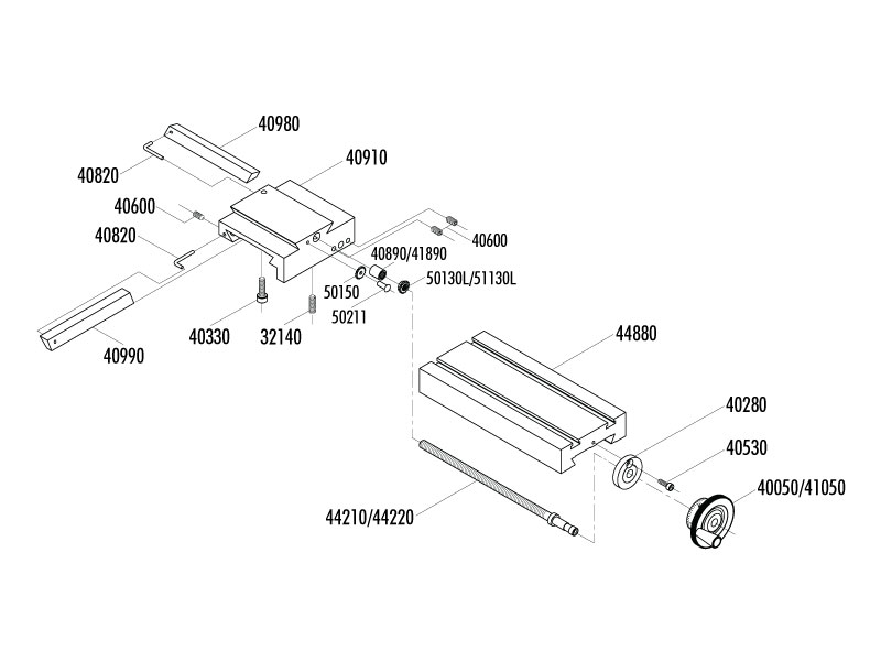

6″ Lathe Crosslide and Saddle Assembly – Manual
32140 | 10-32 x 1/2″ Cup Point Set Screw | 1 |
40050 41050 |
Y-Axis Handwheel (Inch) Y-Axis Handwheel (Metric) |
1 |
40280 | Thrust Collar | 1 |
40330 | 10-32 x 5/8″ SHCS | 1 |
40530 | 5-40 x 3/8″ SHCS | 1 |
40600 | 10-32 x 1/4″ Flat Point Set Screw | 3 |
40820 | Gib Lock | 2 |
40890 41890 |
Slide Screw Insert (Inch) Slide Screw Insert (Metric) |
1 |
40910 | Lathe Saddle | 1 |
40980 | Crosslide Gib | 1 |
40990 | Saddle Gib | 1 |
44210 44220 |
6.5″ Slide Screw (Inch) 6.5″ Slide Screw (Metric) |
1 |
44880 | 6″ Crosslide | 1 |
50130L 51130L |
Lathe Anti-Backlash Nut (Inch) Lathe Anti-Backlash Nut (Metric) |
1 |
50150 | Anti-Backlash Lock | 1 |
50211 | 8-32 x 1/4″ Button Socket Screw | 1 |
