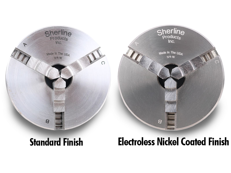

Some of our customers have been wondering how to tell the difference between our standard chucks and those that have the electroless Nickel-Teflon coating. Standard chucks have darker markings than the coated chucks (See Figure 1. Click on photo to view a larger image).
nickel_chuck_comparison
Figure 1—Examples: (Left) 1040 3-Jaw Chuck (3.1″), (Right) 1040C Electroless Nickel-Teflon Coated 3-Jaw Chuck (3.1″).
